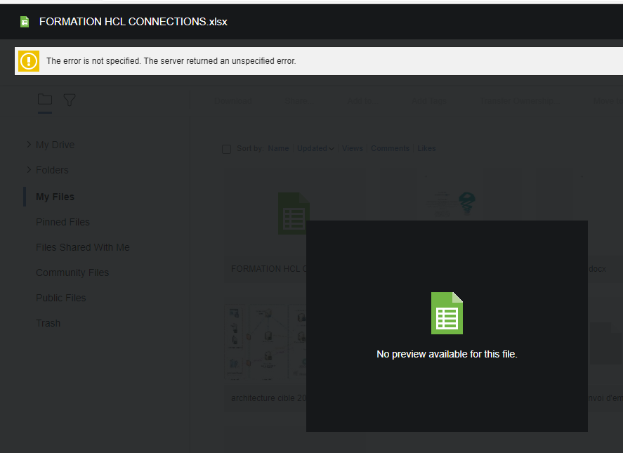

I have a connections server with HCL docs installed on it, (connections 7 on windows server 2016 standard) , i don't know what happned but HCL Doc convertor is not working any more, and i have an error message when i start the server (please check the attached file) . Even when i performe the sanity check i receive 'Error 500: java.lang.NullPointerException'.
All new documents can't be previewed or converted ,
