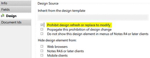

Root Cause Analysis
Upon investigation, I discovered that these agents had the “Prohibit design refresh or replace to modify” setting enabled. This setting prevented the agents from being re-signed with the new ID.
Disabling this setting manually for each agent across hundreds of databases was not practical. I needed a scalable solution to:

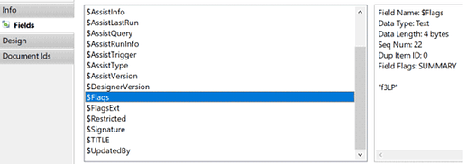

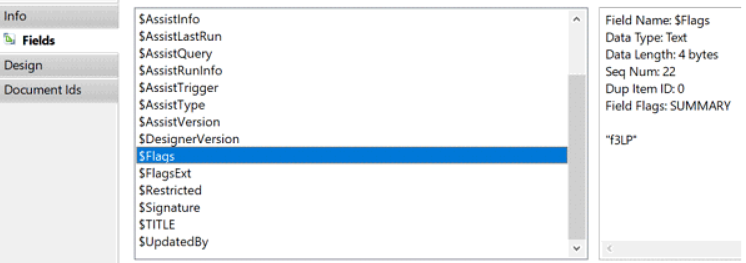

Key Insight: The $Flags Field
While exploring the agent design documents, I observed that this setting is stored in the $Flags field as the character “P”. When enabled, the character “P” is present, and when disabled, it is removed.
This gave me the idea to scan all agents across all application databases and programmatically remove the character “P” from the $Flags field where present.
