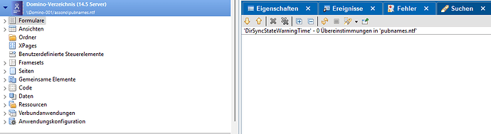

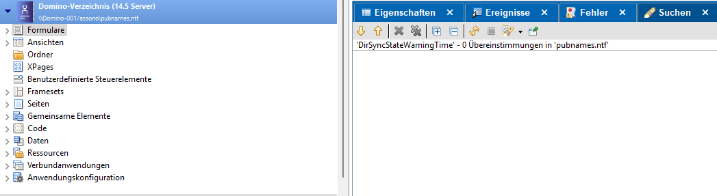

There is no item or anything named “DirSyncStateWarningTime” in the (German) pubnames.ntf:

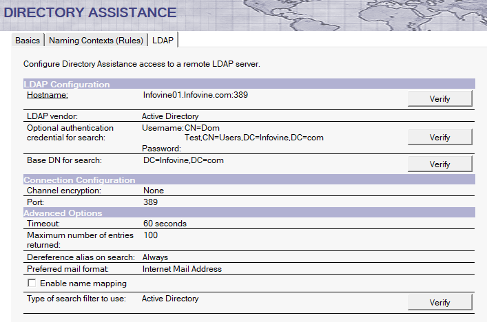

If offline maintenance has been performed for names.nsf, I suggest performing a replace design. Also, perform offline maintenance on da.nsf and ensure that the Verify button in the Directory Assistance for the DirSync document is working properly and not causing any issues.

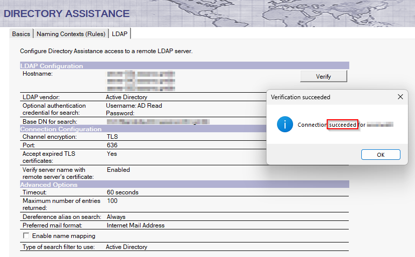

DA connectivity verified:

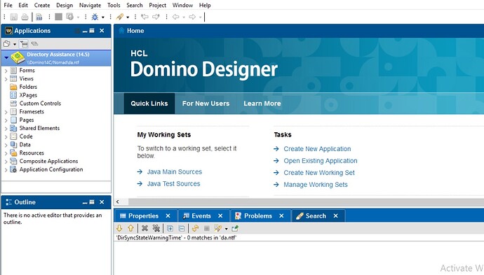

And there is no item named “DirSyncStateWarningTime” in the da.nsf neither:
What surprises me is: In the error message, the item “DirSyncStateWarningTime” is mentioned that I could not find by searching both databases in Domino Designer. In particular, it is not in any of the forms. Where should the item come from then?
Has anyone a chance to check, if there is an item with this name in the English version of pubnames.ntf or da50.ntf? We only have the German version of both databases/templates.

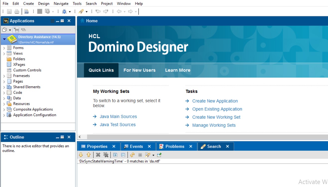

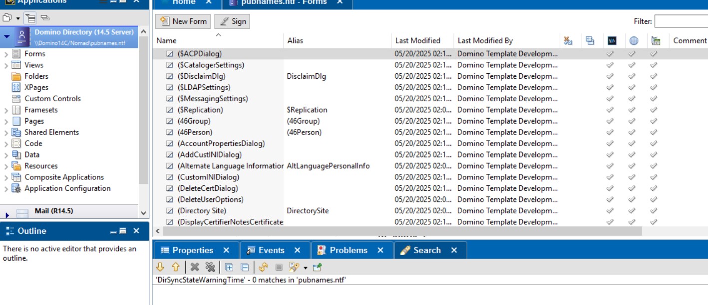

Good day! I checked these two templates and verified that it does not have DirSyncStateWarningTime , Please find the attached images. I would suggest to open a case/ticket if you haven’t done so yet, so we can investigate it further.
