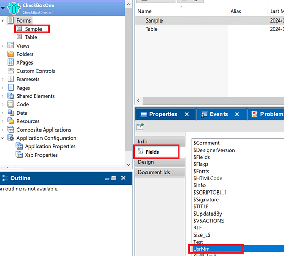

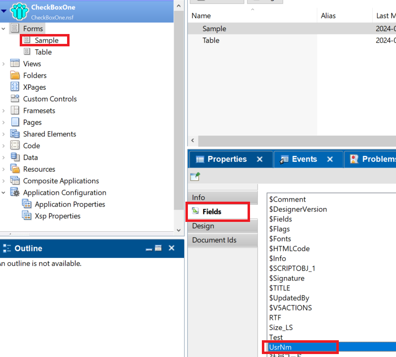

@Satish Bolla
Suppose you expect to see a field "UsrNm" in this "Full Text Index Rules" list.
You are not able to see this field. That's the issue with only one of the specific application using DDE.
Is it like you can see this field at FORM level by checking on "Fields" tab as mentioned in below screenshot?
Also, when you say that issue is not appearing for other application, so is it correct to assume those applications are being opened via same DDE?

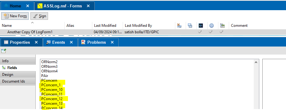

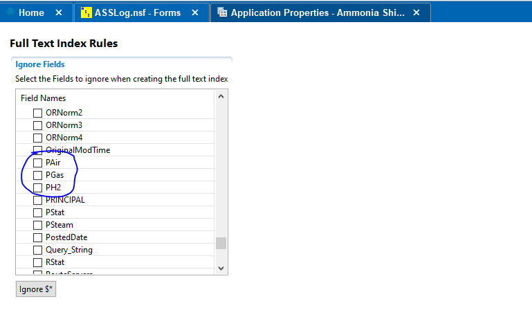

Hi Amit,
Yes, you are right, we are using the same DDE to view all the applications. Regarding your query about the fields being visible at the form level, I'm able to view those fields. Below are the various screenshots.
Missing the PConcern fields in the Full Text Index rules:
Thanks,
Satish.
