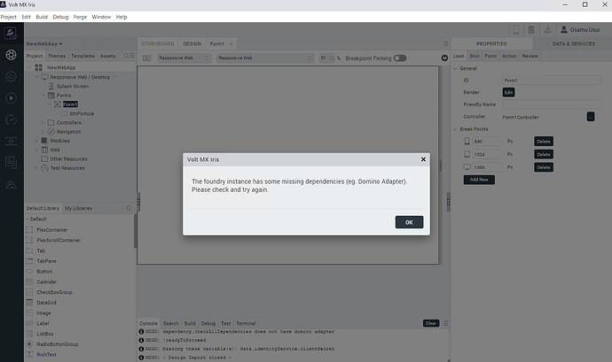

Design Import fails on EA3
When I select the menu Project->Import->Domino Applications, the error occurs as below although the Domino Adapter exists.
"The foundry instance has some missing dependencies (eg. Domino Adapter).
Please check and try again."
On the same environment, the "First Touch Recipes" works well.
What's wrong with that?

Hi Thank you for your support.
I attache the iris.log and output of the console. Iris.log is changed to iris.txt.
ConsoleOutput.txtiris.txt
Greetings, when you link and unlink a foundry app. again did that solve the issue for you?
Hi, thank you.
I did "link and unlink a foundry app" and "unpublish and publish the foundry app" as well.
However, it still fails.
Please let me know when you are free for a screen share to look at this please.
