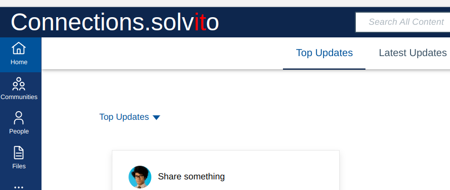

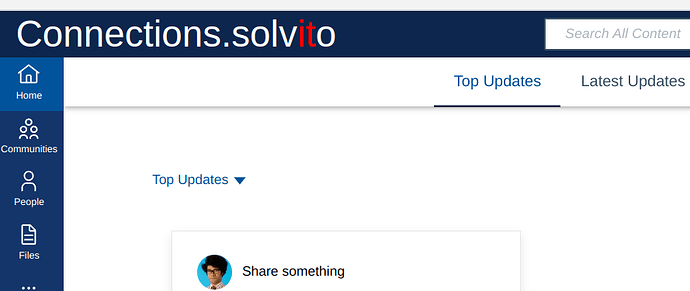

With this json:
    "name": "Connections Custom Config Extension",
    "title": "Connections Custom Config Extension",
    "description": "Connections Custom Config Extension - Description",
    "services": [
        "Connections",
        "Customizer",
        "Customizer"
    "state": "enabled",
    "extensions": [
            "name": "connections-custom-config-extension",
            "type": "com.hcl.connections.custom.style",
            "payload": {
                "style-customization": {
                    "top-navigation": {
                        "logo": {
                            "position": "left",
                            "order": "1",
                            "src": "https://connections.solvito.de/images/sologo.svg"
                "cacheExpiration": 20000
            "path": "global",
            "state": "enabled"
Just had to re-login after I enabled this extension. I use nginx as a caching proxy too based on the LTPA Token.
In the browsers developer tools, you should see multiple requests to /appregistry/api/v3
Usually when something is strange with the appreg, I sometimes forgot to enable the traffic from nginx to mw-proxy
