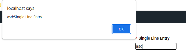

var x = BO;
var y = page;
var z = x.F_SingleLine5.getId();   //Returns:   F_Shortname
var a = get(x,z).getValue(); // Raises error: Caused by: TypeError: x.z is undefined
var b = get(y,z).getTitle();
alert(a + “:” + b);
Many thanks for a sterling bit of help!
