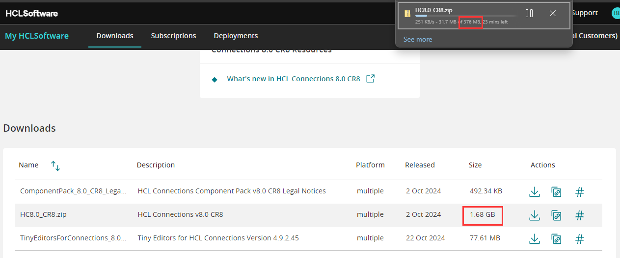

I am trying to download CR8 from the MyHCL Software Portal and although it says it is there when downloading it isn't the correct file it is only 375mb to start with and should be over 1gb. I did try it any way and Install manager says it isn't the correct file.
Yup, verified and confirmed that it seems the CR8 file is only 376mb which should be 1.67gb on https://my.hcltechsw.com/downloads
I'm trying to download it and see if it is a broken one.
If it is, then, we should have someone to look into it and try to replace this HC8.0_CR8.zip with the complete one.

This is being corrected on My HCLSoftware and should be reflected soon. If you need CNX 8.0 CR8 immediately it can be downloaded from HCL Software License & Download portal.

The problem with the incorrect Connections 8.0 CR8 binary has been resolved, apologies for the inconvenience.
