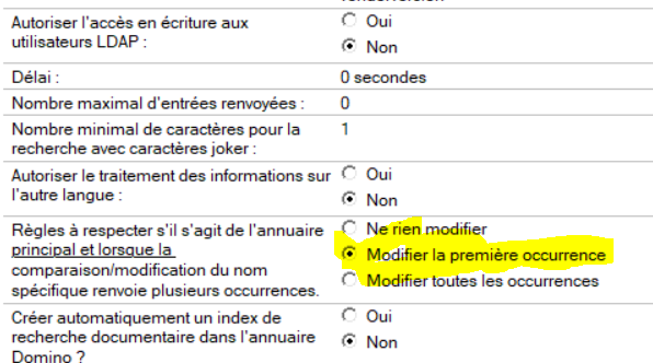

At this stage, It will not work. Now you need to create a LDAP configuration document in the secondary address book with the following setting: (sorry it's in french)
I also set the same setting in the LDAP configuration document in the main adresse book
After that It works
