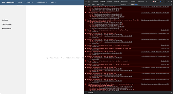

I'm on mission to upgrade our Connections from 6CR4 to 7. I started by upgrading to CR5 including the various WAS/IHS updates to 8.5.5.15 and ran the cr5 databasescripts, and all went fine. Tested the 6CR5 system afterwards, all worked fine. Off to installing CR6, all went fine and tested afterwards, all worked fine. Next step was installing 6.5. Installation ran fine, all install logs said successfull. I cleaned out temp and set a new timestamp as suggested. BUT when accessing the system in the browser only parts of the site loads ....blogs and bookmarks seems to working fine, but the rest is quite a mess.....Homepage loads without any widgets, I can load My Communities page but when I enter a community I get an empty community overview. Overall it seems like widgets are not loading.
I've tried several browsers, cleared all cache, tried incognito mode, all looks the same.
If I access files and communities through Windows Explorer plugin it works fine, same does MyDrive sync .....
I've opened a PMR with HCL but so far we are stuck dead in the water...
Good ideas would be much appreciated :-)
Regards Anders

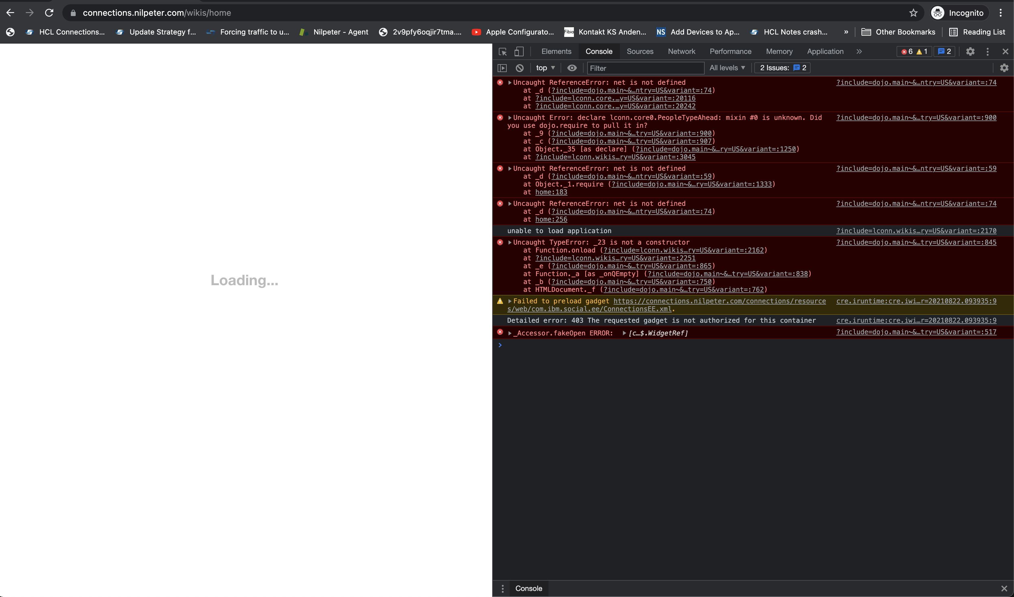

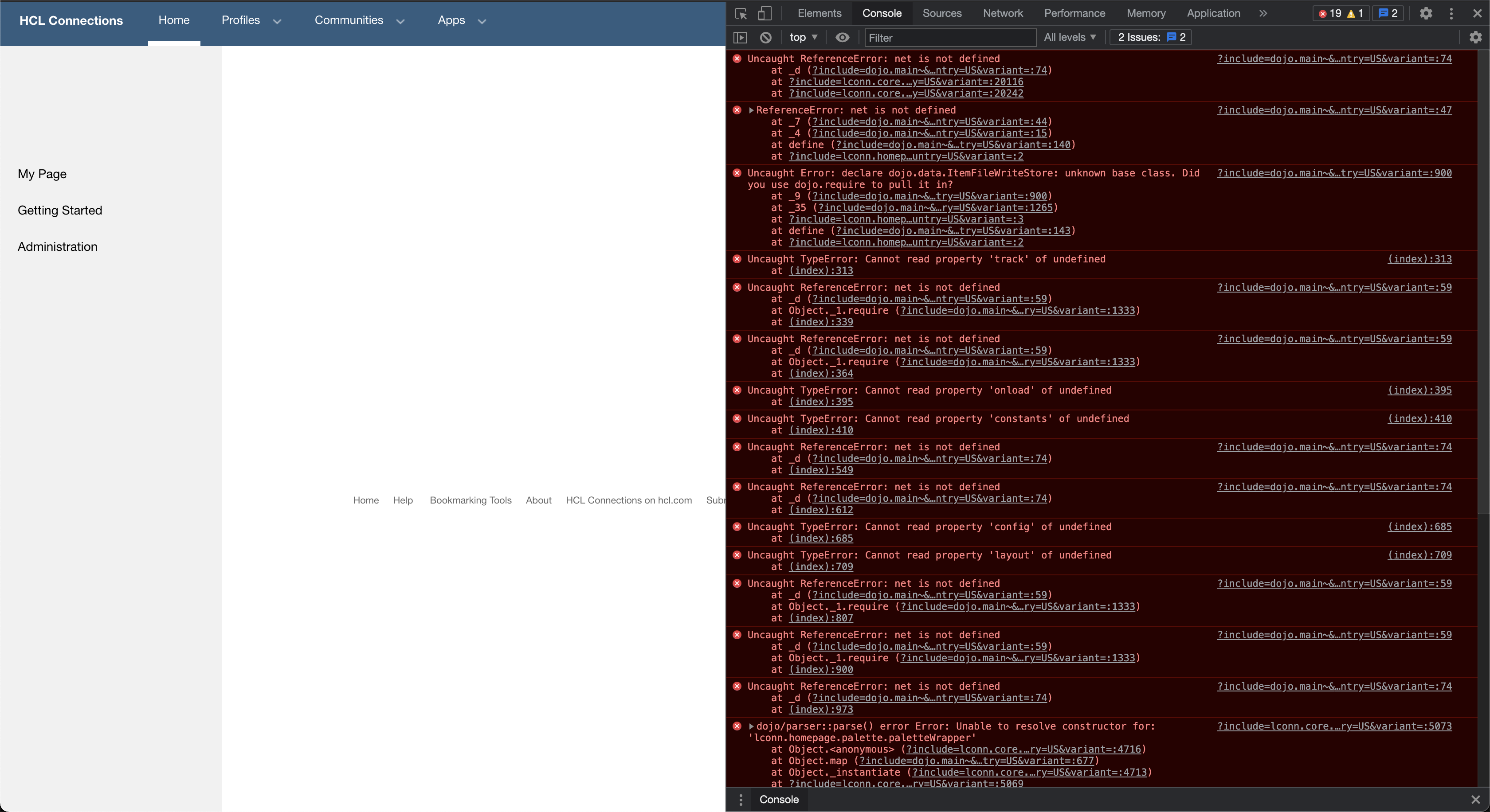

Edited: I've inserted some screenshots from Developer tools showing what is going on under the hood, maybee that can help

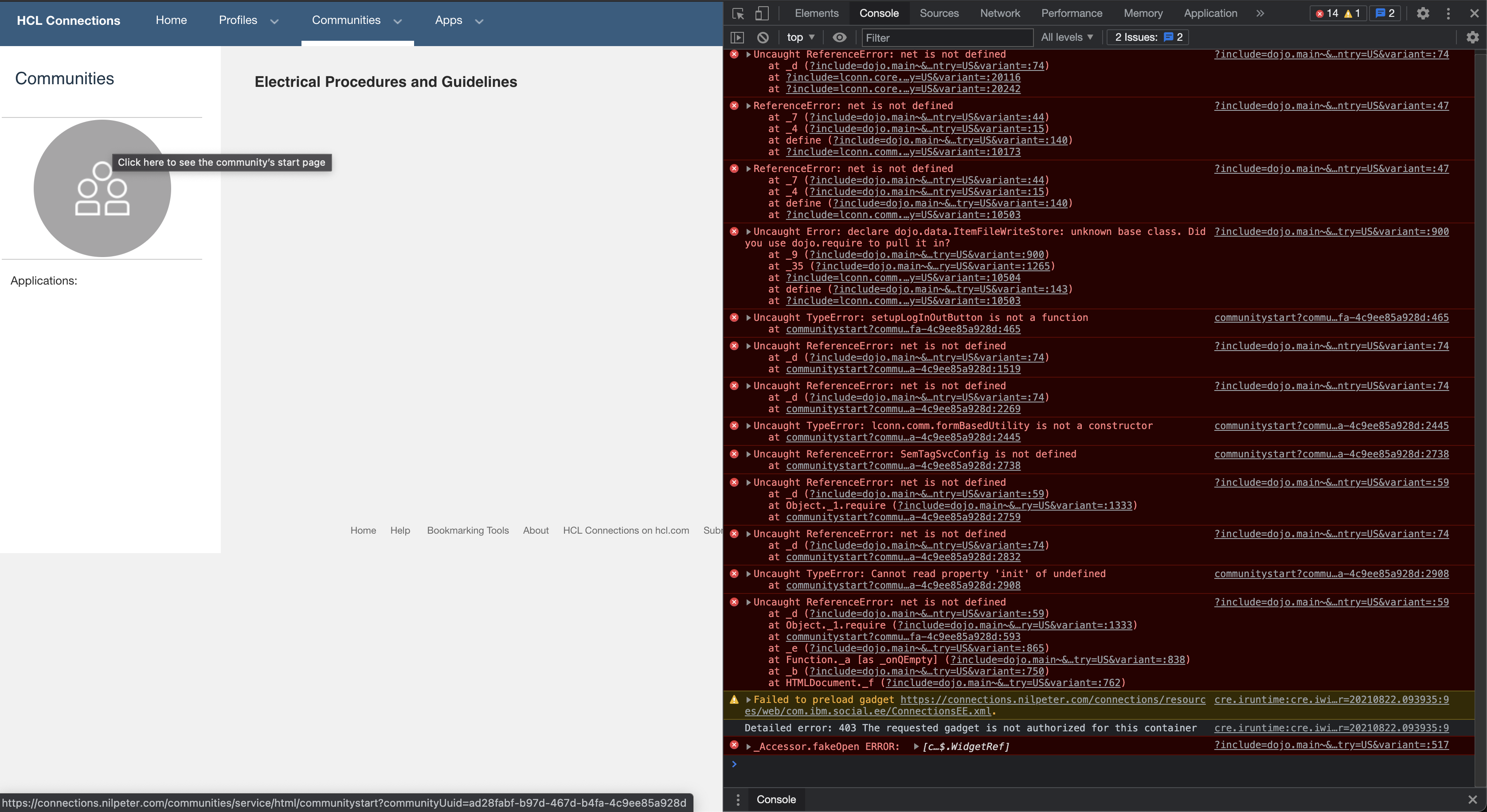

can you upload a screenshot of how the homepage, the profiles page, and a community overview page look?
This might help us and gives us a better feeling about the problem.
Also, a .har file of the browser developer tools might help. e.g. when loading the profiles page. If you don't want to do this for whatever reason, check what is not loading (HTTP status code 401 or 404 or 5xx) and everything that is not loaded from your connections' public hostname.

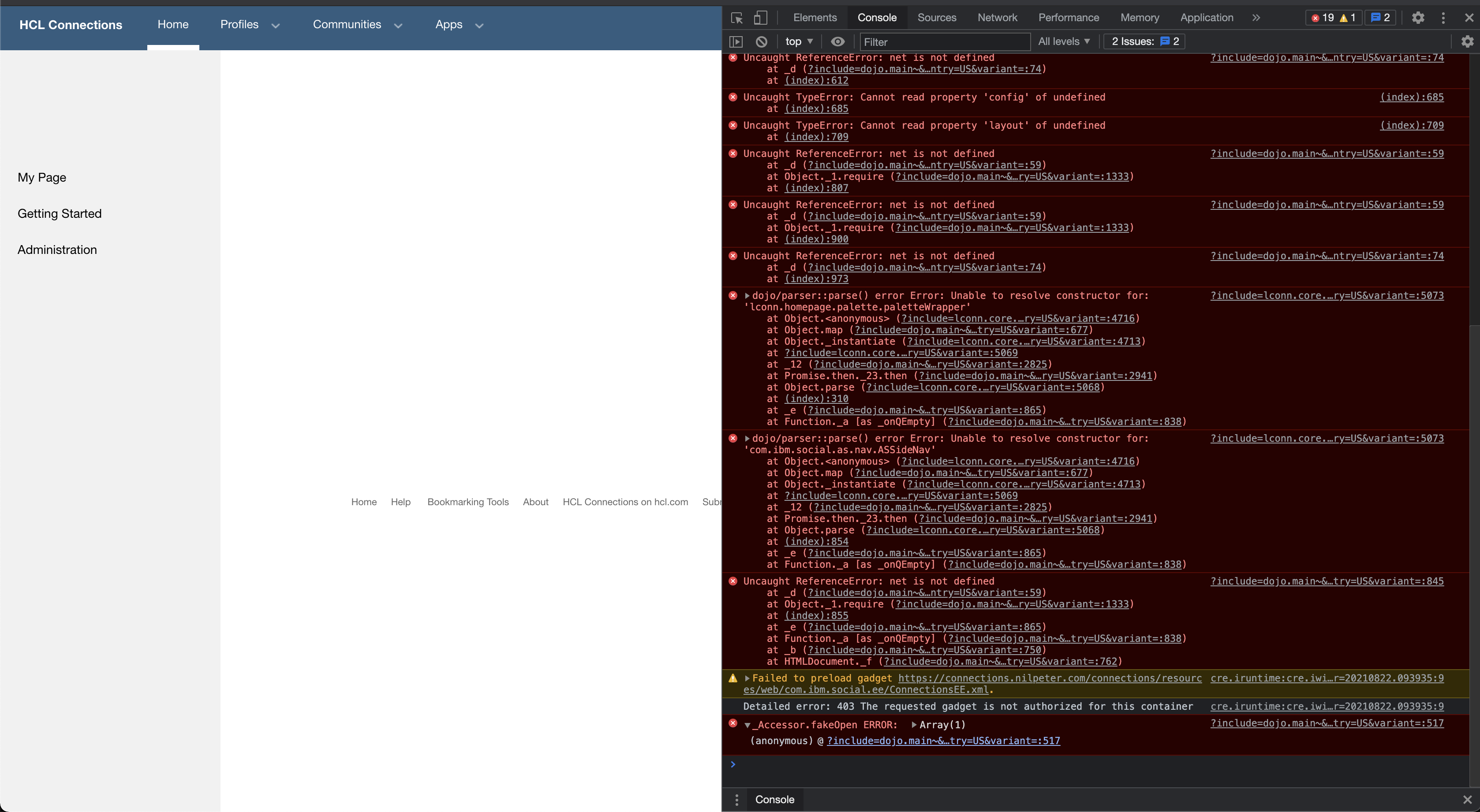

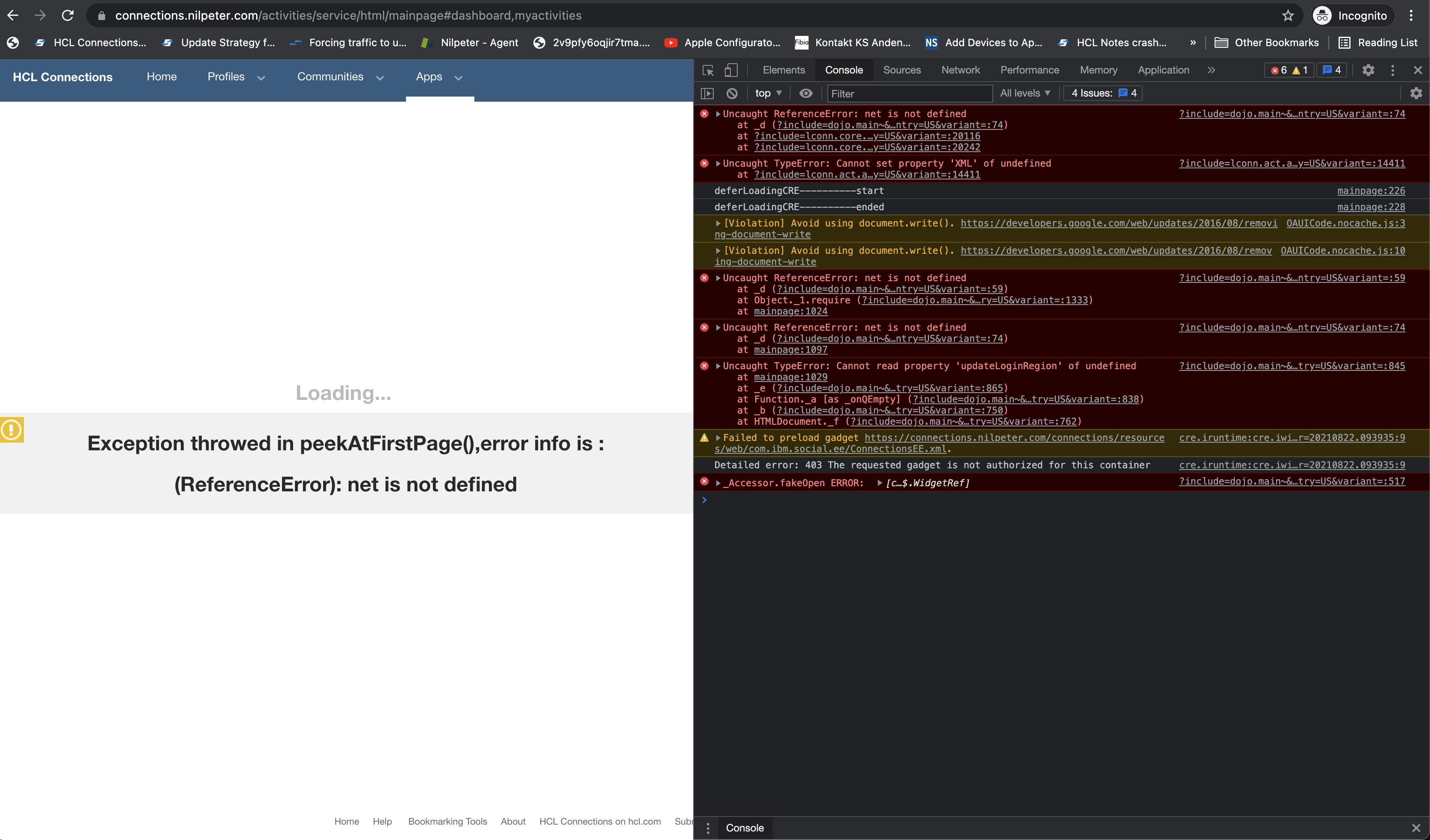

Thanks for your reply. I've attached several screenshots to this reply including the long list of errors shown in Developer tools when opening the page ... I hope someone in here can gather something from these errors, so far HCL support hasn't been much of a help getting anywhere ...

It looks like a lot of dojo classes are not loaded.
Unfortunately (and maybe I did not explicitly ask for) you did not show the Network Tab of the dev tools. I wanted to check which resources are not loaded.
I would also expect that a lot of errors are shown in the SystemOut.log of the InfraCluster Server (or where the Common Application is running).
To check this, I would try to find the start of the SystemOut.log where the WAS Server starts (the section with a lot of stars and the hardware info and then scroll forward until you find the first 1-3 exceptions. Check if you can understand what causes this exception.

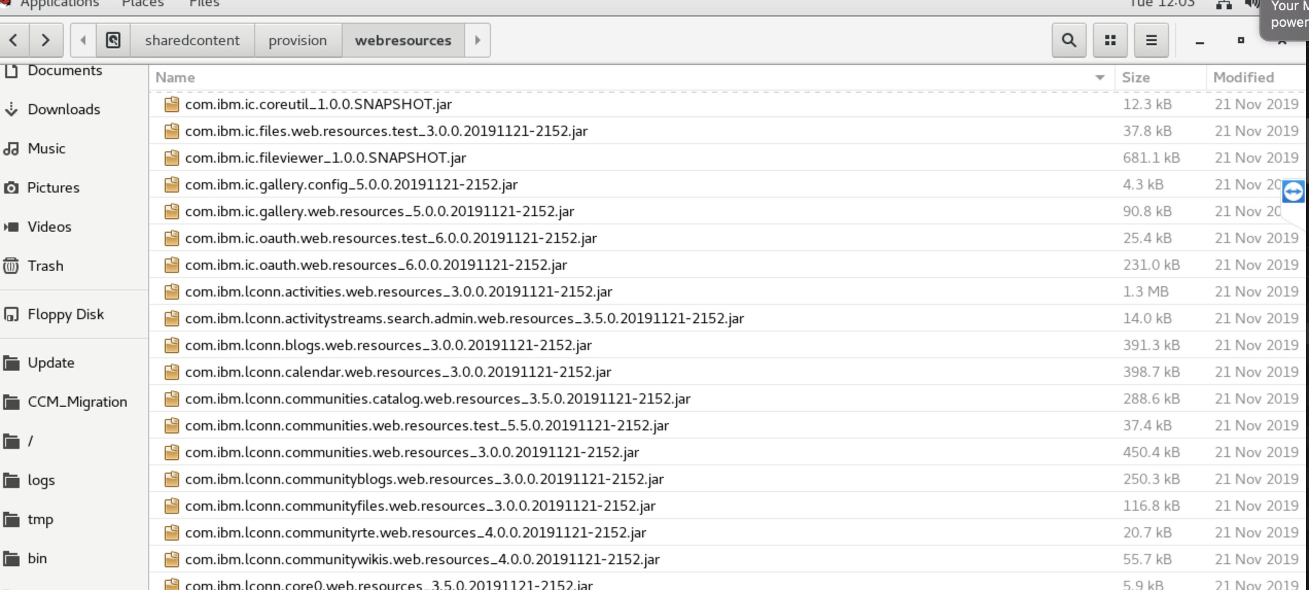

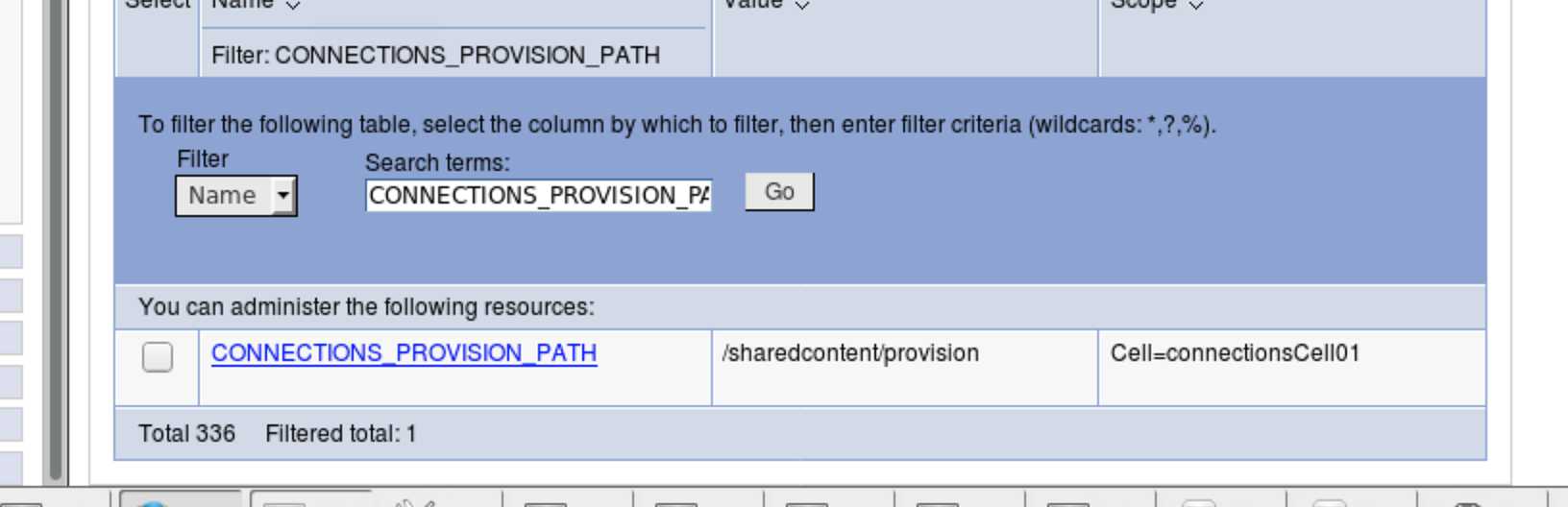

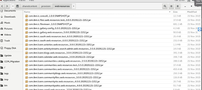

Can you also check that the <data/shared>/provision/webresources directory exists and is filled with .jar files? This is the path that is configured in the WAS Variable CONNECTIONS_PROVISION_PATH + "/webresources"

I also checked the provision directory and that seems to be fine, see the two screenshots below
