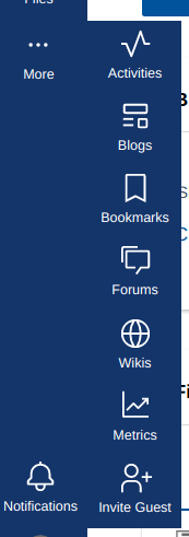

I found "Invite Guest" below ...More

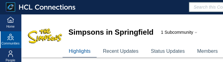

Subcommunity from parent you have the dropdown:
From Subcommunity:
Back to parent. I think this has not changed to latest Cnx 7 UI.
