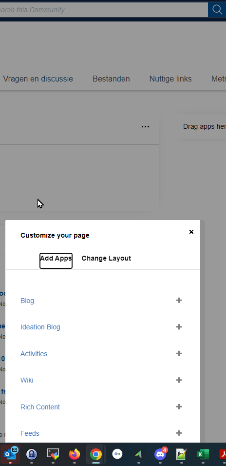

Why does the only way to change the layout of a community seem to be the "Add Apps" button? That doesn't really make sense?
I have some problems with this button. That's my 3rd question. Anyone an idea how to solve this?
To be clear, the bottom part of the dialog isn't accessible.

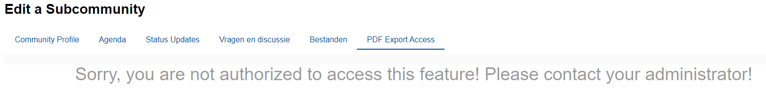

When I edit the community, there's a new menu option: PDF Export Access. However, clicking it gives me this:
I would be that administrator. Does anyone know what is needed to enable this option? I can export a pdf from a standalone wiki, so ic360 seems to be working.

---2. In order to show the "Change Layout" option in the Edit Community menu when Highlights has been added, a user should set the default landing page to any page other than Highlights. Then the Change Layout option appears again.
Customizing the Highlights page
As stated in the documentation, it was already implemented before that highlights replaces the Overview.:
Highlights page is now the standard landing page for new communities, and is even easier to lay out and customize. Easily add widgets from the traditional Overview page as well as
---3. As for the PDF Export, Please see the Documentation:
HCL Connections Extension Toolkit (ICXT)
If you have not installed the full feature of the HCL Connections Extension Toolkit (ICXT), this could be a reason.

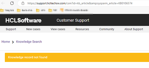

Thanks for your elaborate answer. I'm surprised by the first, as this is a blocking issue for me and I can't imagine this wasn't noticed earlier. Was this a regression in CR4? The URL regretfully doesn't work for me, so I can't see what's in the KB article.
Hi @Ariel Lazaro , could you double check the link to the technote?
Hi,
Looks like some formating issue with the ampersand.
Please try this:
https://support.hcltechsw.com/csm?id=kb_article&sysparm_article=KB0106574
