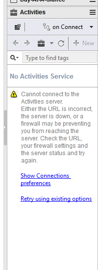

I'm using the Notes client Connections plug-in , to connect to my hcl connections server ,
everything is working fine except the activities in the notes client sidebar, it keeps telling me that i can't connect to server , although i'm sure that my parameters are correct, in addition i can connect successfully connect to files app which is on the same server.

checking the error-message in your screenshot the problem seems to me more network related than HCL connection product related. it is maybe possible that a firewall block that specific communication. How did you configure the client to connect to the connections server? Did you already check the SystemOut.log of the connection server, if it showing up any errors? It is maybe not worth to enable detailed networking traces on both sides to find out more. On client side you can try to use wireshark to check, if the server is blocking the connection.

Hi,
I've been in contact with HCL support team, and i wanted to share the provided solution with you,
I've been using the format "First name Last name " for login , in the connections login configuration ,
When i change it and use the email adresse , it works without any problem, i didn't have any explanation for this , especially that the files section is working in the same plugin, but it works.
