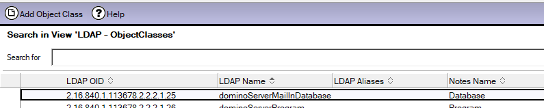

It is enough to add mail-in db in LDAP query you are ussing: you can add something like this (objectClass=dominoServerMailInDatabase)

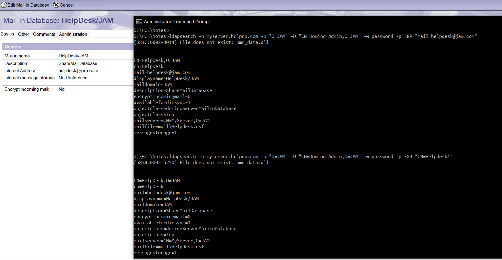

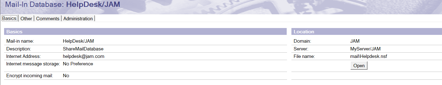

I have below mail-in db on my Domino 12.0.1 server.
I can get the mail-in db result via ldap query as below.

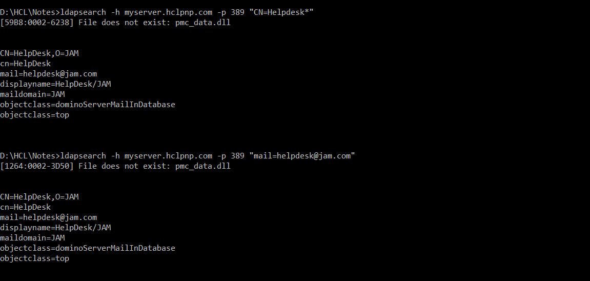

With anonymous access ldapsearch gives result as below for mail-in db. Thank you.
