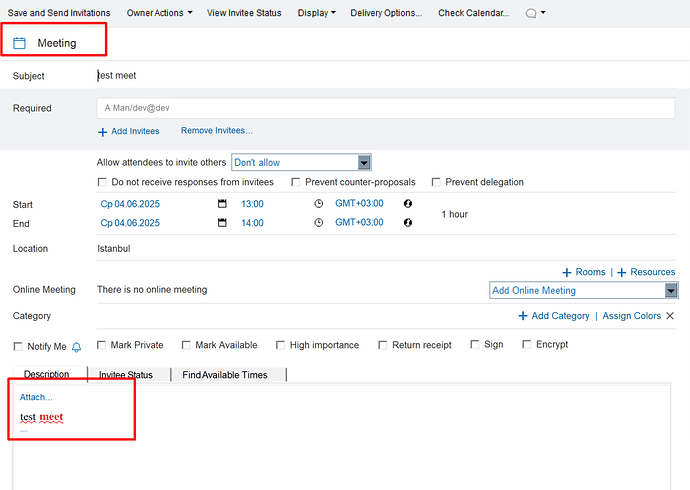

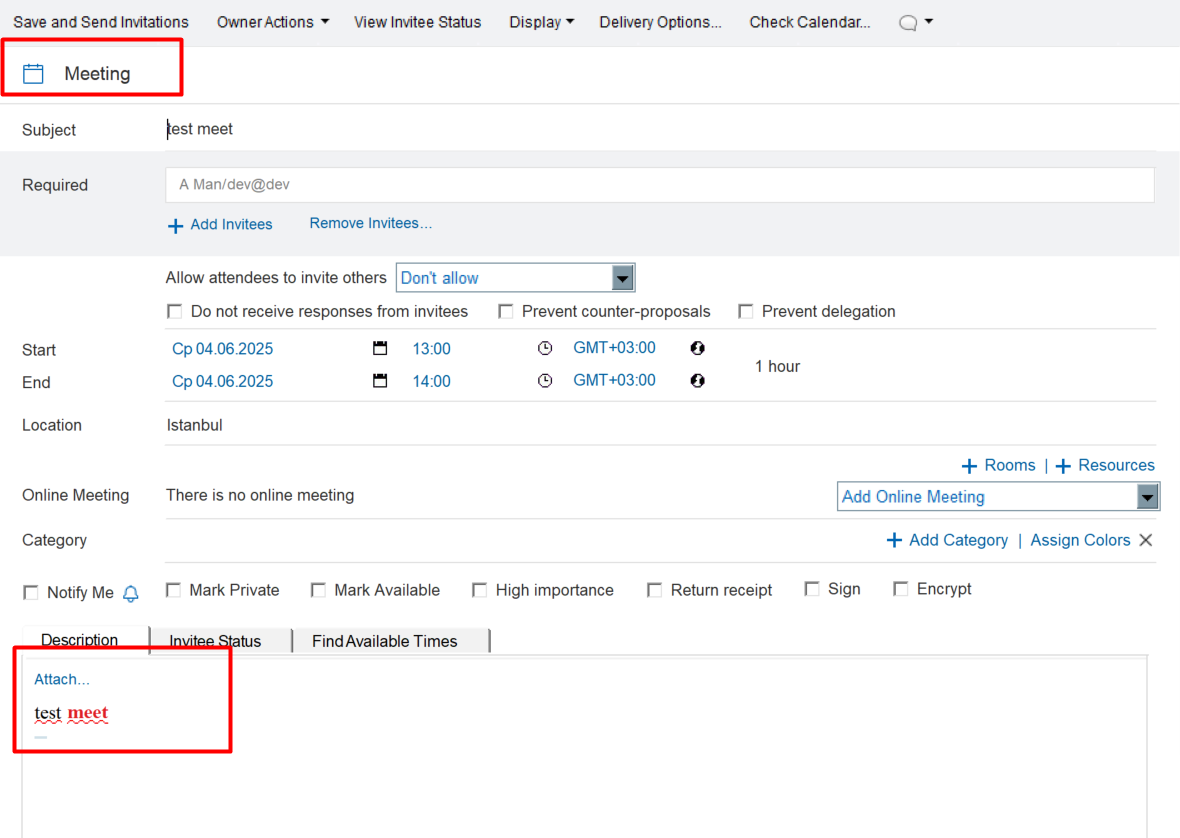

1 - A meeting is created via Verse. The appointment after co-creation looks like this:

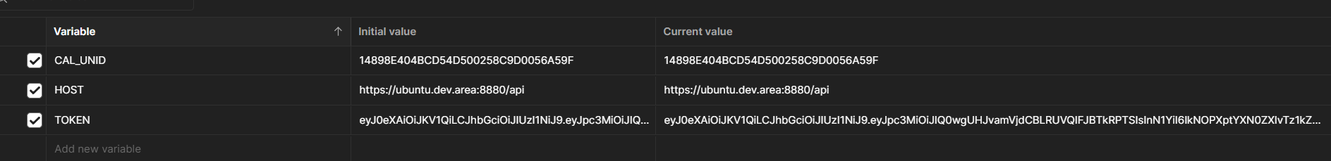

2 - There are 3 variables in Postman:

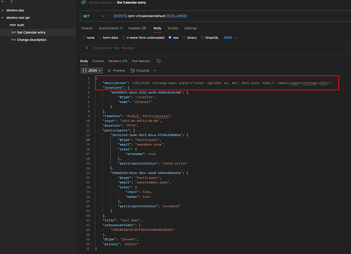

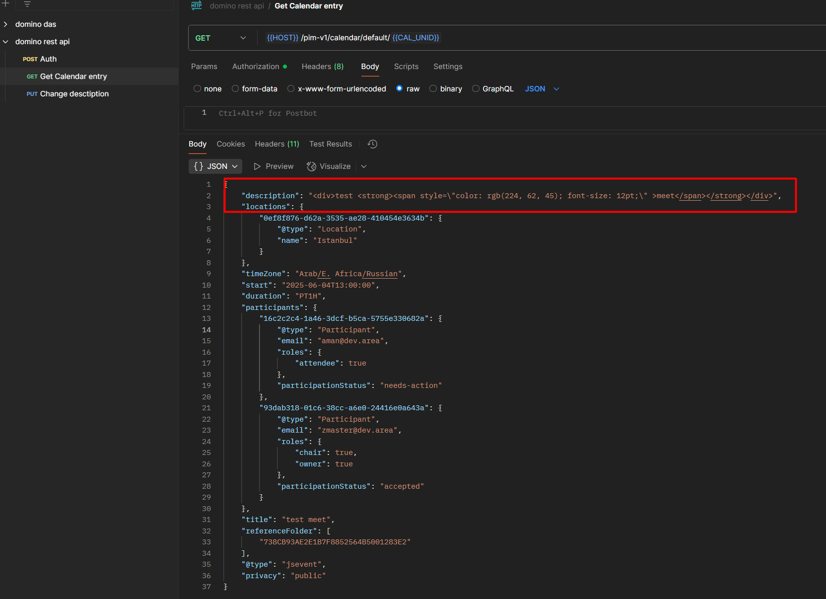

REST - {{HOST}}/pim-v1/calendar/default/{{CAL_UNID}}:

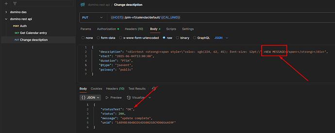

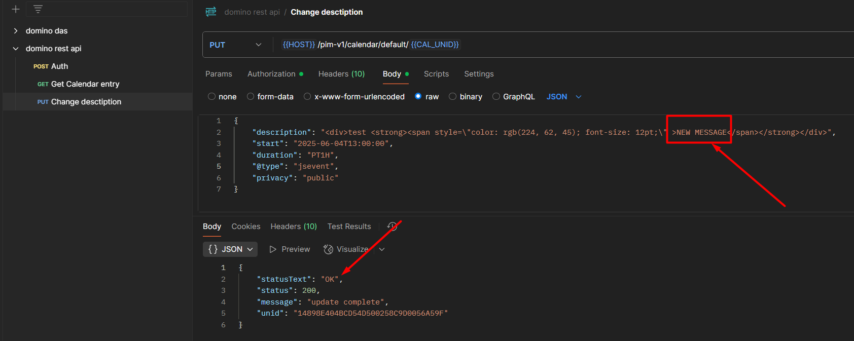

4 - Now I need to change the description while keeping the formatting intact. REST - {{{HOST}}/pim-v1/calendar/default/{{CAL_UNID}}:

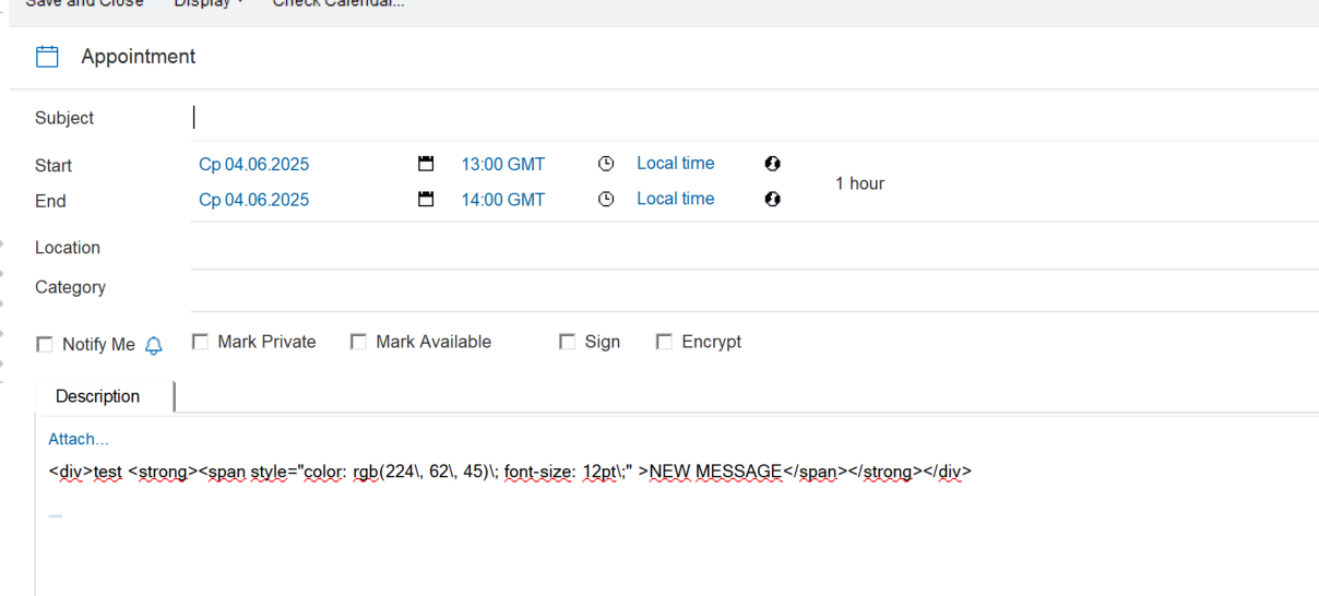

5 - The change request is working, BUT the appointment has now changed view and the description has broken formatting:
What is the problem and how to deal with it? Please help me to understand )))

Hi @Aleksandr , yes, you are correct, that appears to be broken. I believe the original intent was to use MIME for PIM, but where the get returns HTML, you should be able to put it back as HTML.
I will create a ticket to resolve this in the next release (the version following v1.1.4 as that is in the queue to be released soon).

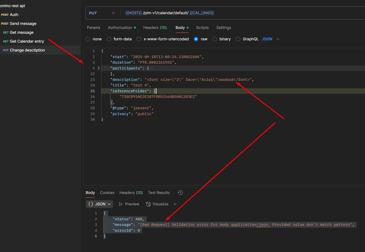

Hi. 1.1.5 has been released. It says the issue has been fixed.
However, now I can’t update the meeting at all.
I do a GET requets, copy the JSON contents, and paste them into the body for PUT request, but after updating to 1.1.5, the server response is always:
How can I fix it, or what am I doing wrong?

I was able to reproduce, no suggestions at this time, in the process of determining where this failure started. Unfortunately any fix won’t be available before v1.1.6.
