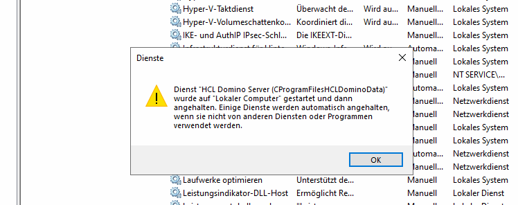

last time, I did this, I got following message:
Hi Jürgen,
when the service fails to start, the server controller was unable to bind to the IP.
Check the latest dcntrlr*.out file in data to see what the issue is. Usually you will find something like "Cannot bind to <old host name>:2050"
The connection port is defined in dcontroller.ini but you cannot edit it there. It gets its value either form the server document or from notes.ini and will always be overridden.
Adding the old old host to the hosts file can temporarly fix it to get the server up.
Can you share the screen shot of the Domino service and the error message when try to start the Domino server as service.

Short form checklist:
  1. On the old server: Change IP and hostname in server document , server configuration document and web site document
  2. On the old server: Change translog and DAOS paths if you plan to move them to a different drive/path
  3. Check 3rd-party systems if they may be accessed by the new server, e.g. ESA relay access tables, firewalls, etc.
  4. Shut down old server
  5. Move data to new server
  6. Move notes.ini and jvm customizations to new program dir, create dir if neccessary
  7. On new server: Search notes.ini for occurences the old IP and change it accordingly
  8. On New server: Search notes.ini for and Directory pathes and check / change them
  9. Check settings in dconsole.ini / dcontroller.ini
  10. Edit C:\windows\system32\drivers\etc\hosts:
    Add a line
    <domino name> <new hostname> <new fqhn> <old hostname> <old fqhn>
  11. Install Domino on top of existing new directories
  12. Change DNS alias of <dominoname.mydomain.com> to point to the new host
  13. Start server. If the service fails to start, check dcontroller.ini host setting
Hi Friedhelm,
that looks good, I think change in the server document will solve my problem.
thanks you
Jürgen
