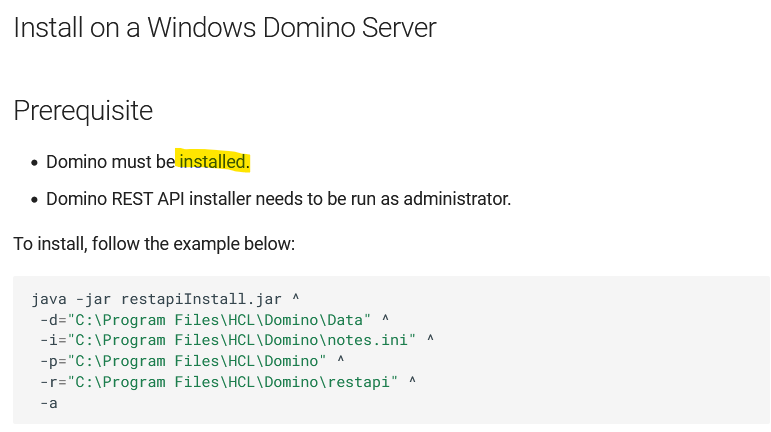

Note: we need no link to the Domino marketing site which is insert in the prerequisite section of the RestAPI installation page

In my first step to use the restAPI installer I failed, because not every installation has default paths. So I created a flexible script to install the RestAPI on Windows Domino successful.
SET INSTALL_PATH=%cd%
SET JAVA_BIN=C:\domino\jvm\bin
SET DOMINO_PRG_PATH=C:\domino
SET DOMINO_DATA_PATH=C:\domino\data
SET DOMINO_INI_PATH=C:\domino\notes.ini
SET DOMINO_RESTAPI_PATH=%DOMINO_PRG_PATH%\restapi
cd %JAVA_BIN%
java.exe -jar %INSTALL_PATH%\restapiInstaller.jar -d="%DOMINO_DATA_PATH%" -i="%DOMINO_INI_PATH%" -p="%DOMINO_PRG_PATH%" -r="%DOMINO_RESTAPI_PATH%" -a

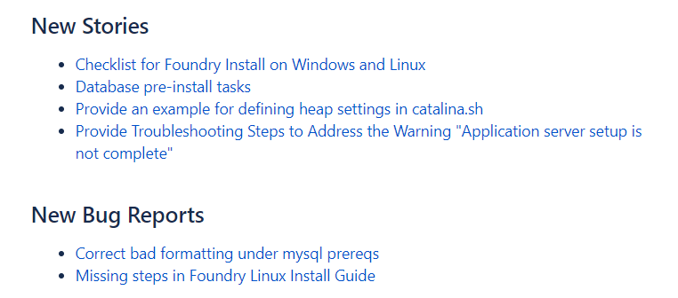

Hi Martin,
I have opened the following stories and bug reports in Jira for the Volt Foundry Development and ID teams to address. I will also be lending assistance if needed. Please forgive and correct me if I have overlooked anything.
Please feel free to provide additional documentation based upon your experience and we can work to incorporate it into our documentation.
Thank you,
Mark Benge, HCL Labs
