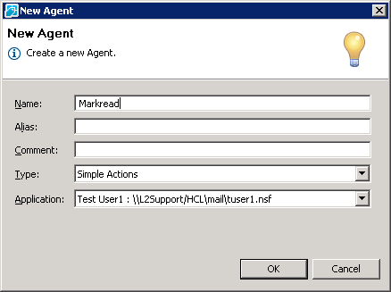

You can create a simple action scheduled agent by following below steps:
Open user's mail file.
Create --> Agent --> Select 'Simple Actions'
Name the agent and click on 'OK'

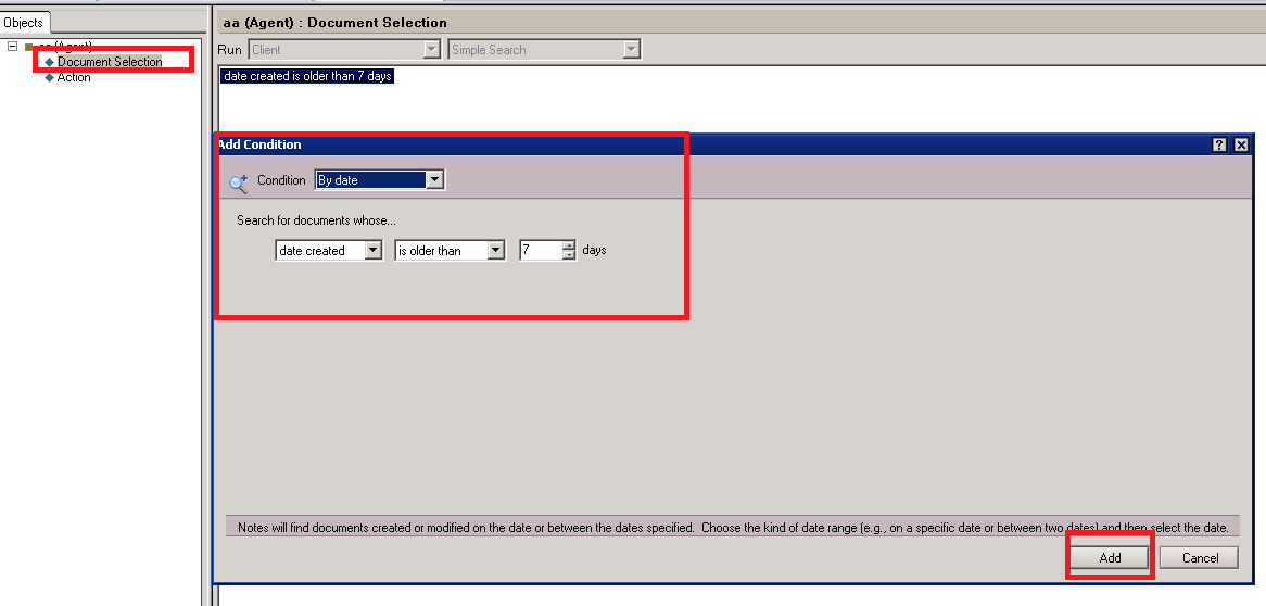

Click on 'Document Selection'
Click on 'Add' and select condition as below :

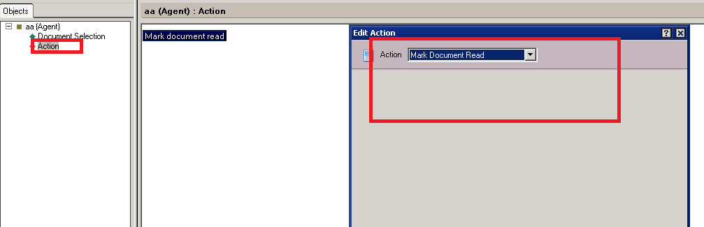

Click on 'Action' on the left pane, click on 'Add' and select as below :

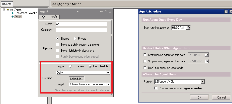

Go to Agent properties and select the agent schedule as below :
Click on 'OK' to save the agent.
