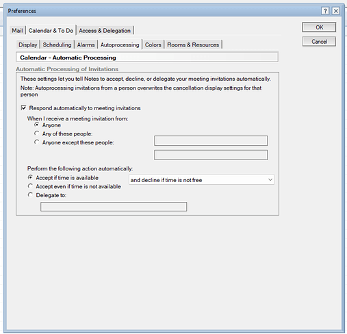

Hi all,
Users are using Verse. And they don't have the option to set up Automatic Processing of
Iinvitations as they had before:
Could you please tell me how to fix this problem in Verse?

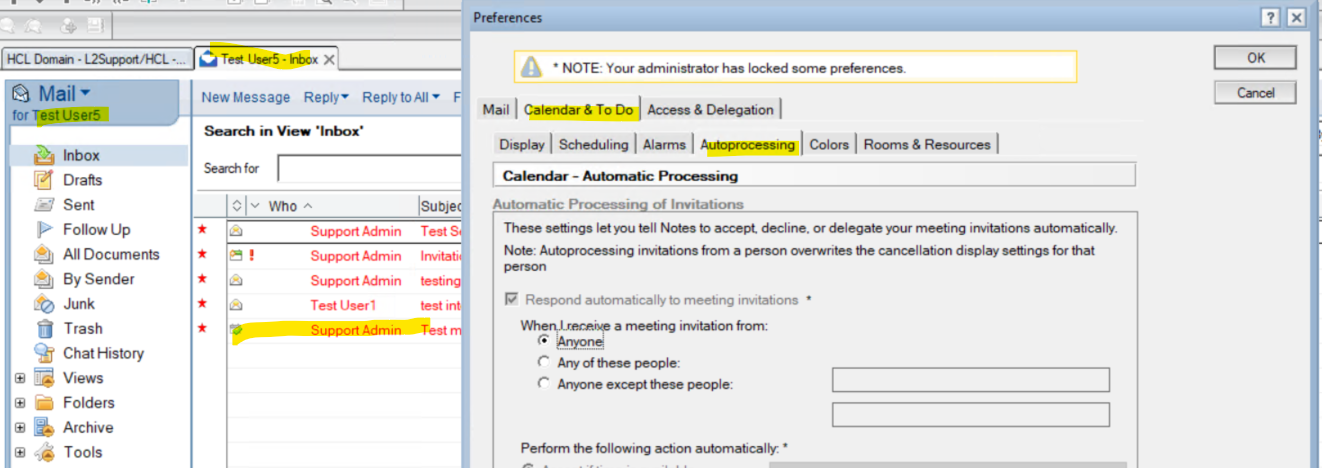

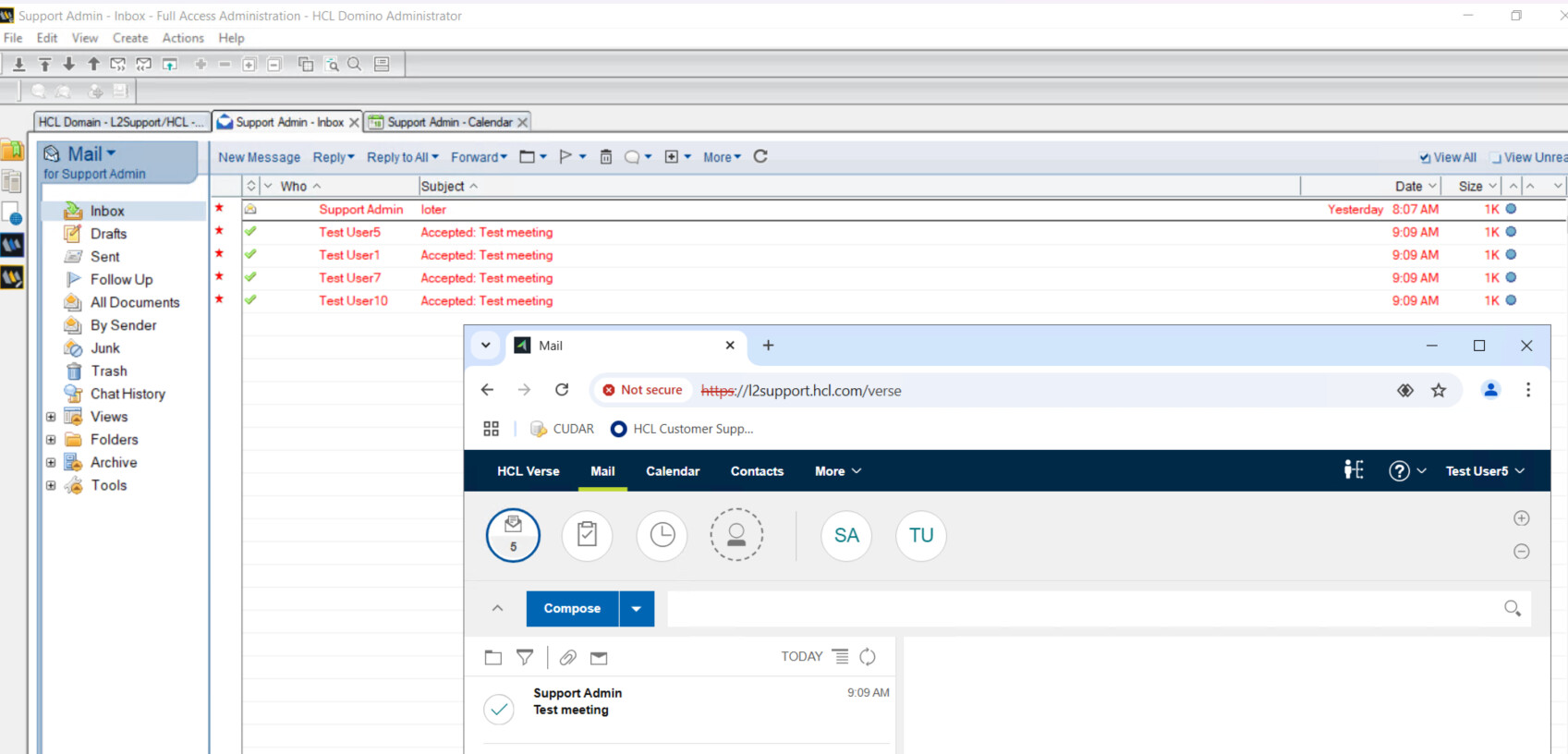

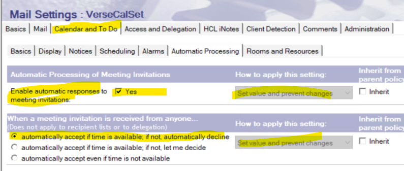

Hello Moises,
The setting is saved in the user mail file CalendarProfile document and this can be controlled via Mail Policy as below.
When you set this via policy to the Verse users. They are reassured the setting is enabled, and automatic acceptance would be sent even when they use Verse as below.

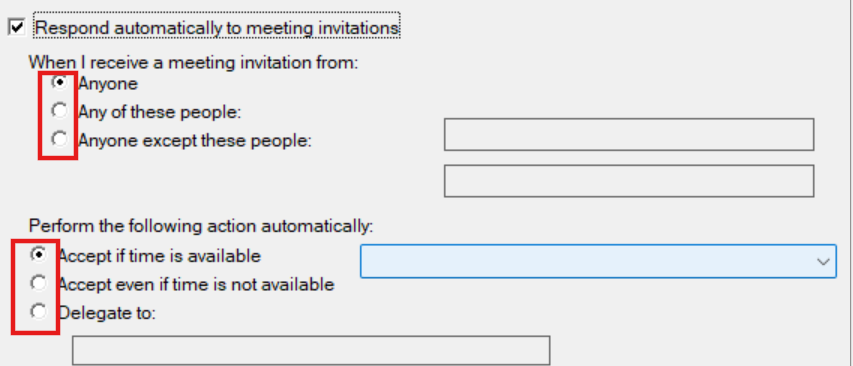

Hello
Thank you for your answer and help.
We have thought about policies too. But the problem is that autoprocessing is needed for thousands of users. And each user set up autoprocessing for themselves as there are different variants:
Maybe there are other possibilities with closing this problem?
Thanks in advance and have a nice day
Moises, this would be an enhancement in Verse. Please submit an enhancement in the Domino AHA portal.
