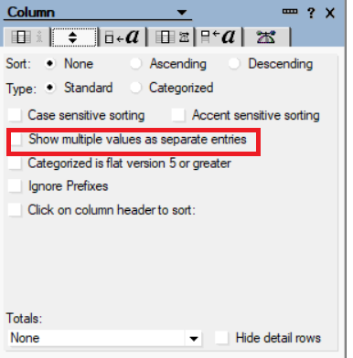

Hi Ajeet
I don't think it is possible to show the each attachment in a separate column. Instead you can show as
separate entry for each attachment under column properties.
