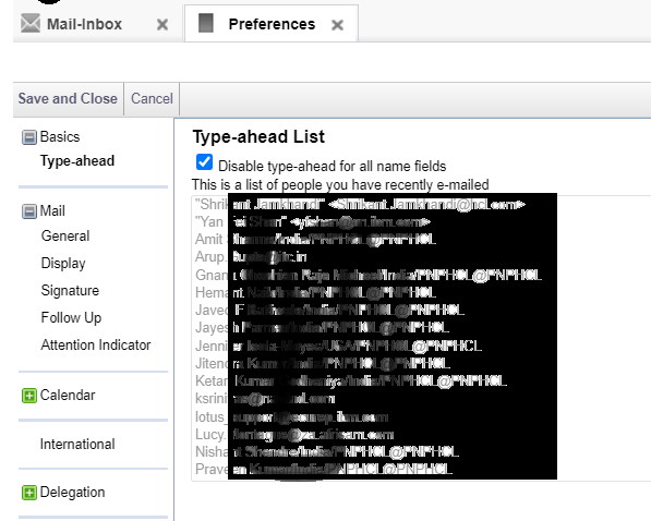

I'm having several users reporting that type-ahead contacts are not working for them.
We have initially set a Desktop policy to disable type-ahead, which has now been enabled again.
According to the documentation, Desktop policy does not affect iNotes regarding this. This is just to provide some context.
Users are complaining that Verse is not providing type-ahead contacts for them.
My questions are:
If a user in iNotes has type-ahead disabled, will this be also disabled in Verse ?
If so, Is there any way that I can enable type-ahead in iNotes for all of our users ?
Just to confirm, type-ahead works only from new emails, right ? So, Isn't there any way to populate type-ahead from existing mails in user's mailboxes ?

Hello Elvis,
Most of the iNotes settings are adhered in Verse. Yes, Desktop policy settings "Disable type-ahead for all names and use the Notes Basic type-ahead" will not affect iNotes as documented in the below link.
https://help.hcl-software.com/domino/11.0.1/admin/conf_settinguptypeahead_t.html
Verse uses the same recent contact list that iNotes uses (DIPS data in the profile note). The type-ahead feature in VOP will use the following data to display names:
1. Recent contact list
2. The sender names of emails that have been loaded in the message list.
3. Names of the people that appear in the Important to Me bar.
My comments.
- If a user in iNotes has type-ahead disabled, will this be also disabled in Verse ?
=> Yes, it will also be disabled in Verse.
=> You may use a LotusScript to update the iNotesProfile item value "DisableDPABProcessing" to set as "0". This agent is created on your names.nsf (Domino Directory). You can take full access administrator access to run this agent. Note, in the agent properties the target should be set as "None".
You can select single person document or multiple person document to run this agent. Please have this tested in TEST environment first.
=> The list will picked from the "DIPS data in the profile" in the mail file. If the settings is disabled as below but, if you have data in this profile in the item "DPAB" which will contains all the recent contact list. When re-enabling the setting should use all data what it has already in it for Verse and iNotes.
