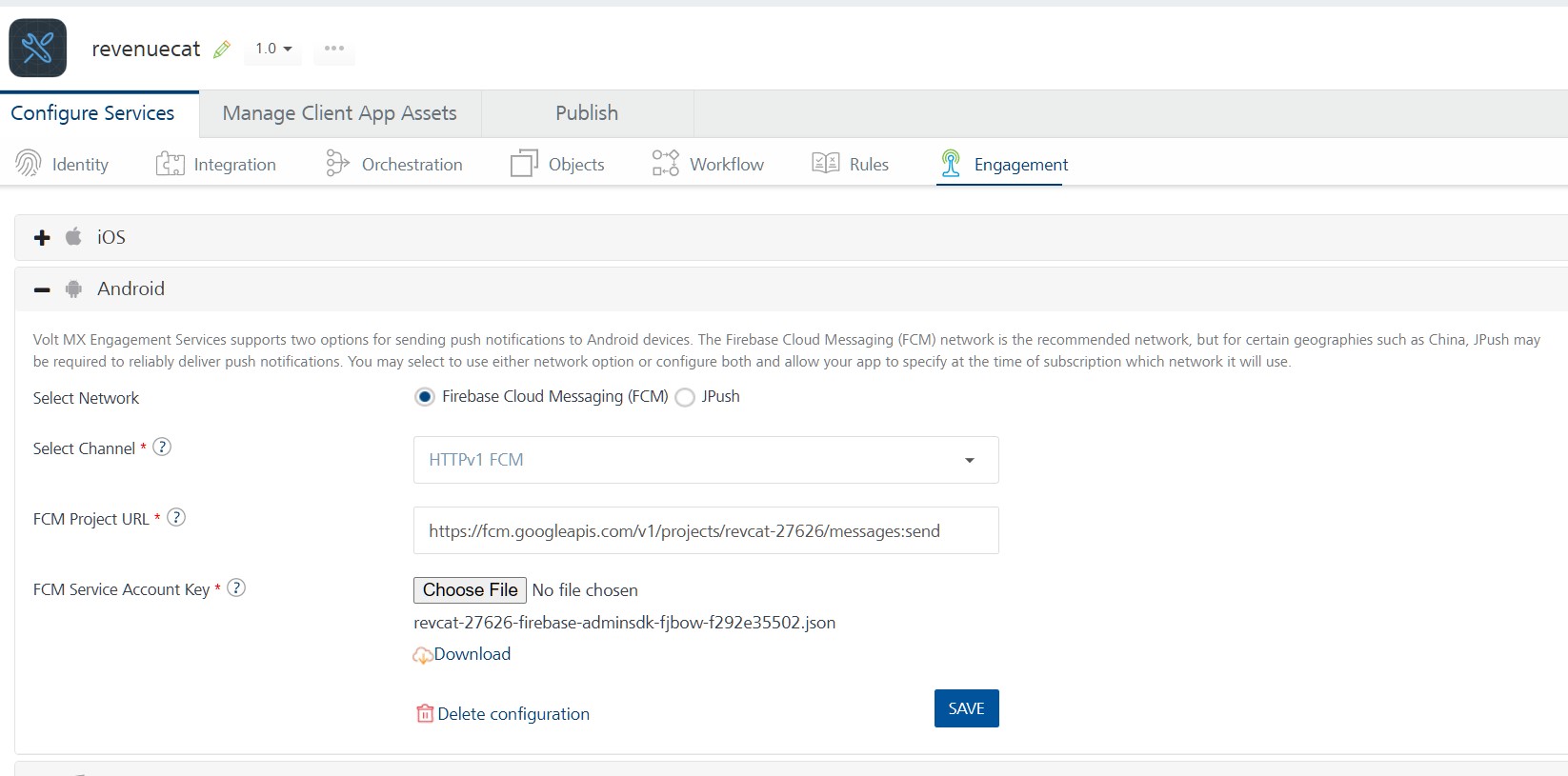

Thanks, @Murali Boddeda for the reply. I have also set up the Engagement service for Android in the Foundry console. After reviewing the code from the GitHub repo that you provided, I tweaked my code and it is working fine.
But here is a catch, it only works for the preview version inside the Volt MX Iris app. The devices are registered inside the engagement service, and I can even see their details in the Engagement console.
But when I build the apk for the Android app, then I do not get any response after allowing the notification prompt. The code doesn't go in any of the specified callbacks. Why is that happening? I guess I have to do something to make it work in the apk.

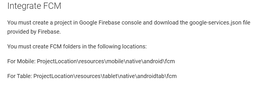

While searching on my own, I stumbled upon this article and it says that we have to make a folder named fmc inside the project directory. Although, it never states that we have to put the google-services.json file inside the newly created folder, I have done that.
Despite all of these things, I am unable to register the device via an apk.

I have just set up the Engagement service on Foundry. I have tested out it on multiple devices having OS v11, and 13. It doesn't work for any of those in the apk, but for the preview mode, it works.
By the way, do I have to provide the google-service.json file in my volt mx project directory? I am using the service in my project, not in the one that I downloaded from GitHub

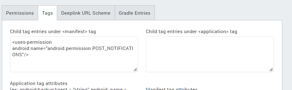

@Vishal Vats For Android if Target SDK version is 33 and above, below permissions is required in IRIS project setting -> Native-> Android Mobile/Tablet -> Tags (Child tag entries under < manifest > tag) uses-permission android:name="android.permission.POST_NOTIFICATIONS" and then check the issue.
It's already there. The weird thing is that if there are some issues with the apk calling the register method, then why the onfailure callback is not called?
Also, seeing the same code work in Volt MX Iris app, and not in the apk is really weird.
