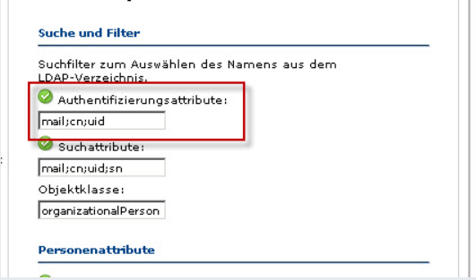

In older Versions of Sametime one could add the attribute "uid" to the authentication parameters by simply adding it to LDAPServer configuration to "Search filter to use when resolving a user name to a distinguished name" field in stconfig.nsf.
In websphere based versions with Sametime console you could add the uid attribute to the "authentication attributes" (German screenshot below):
So there had always been two different search strings, one for searching users and one for authenticating users...

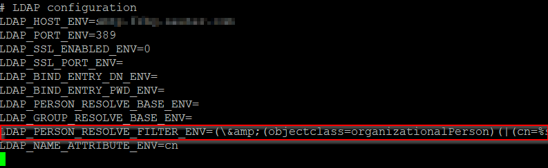

In Sametime 12 I only find one of these:
And changing it does not allow users to login with their short name (uid property).
Is there a setting in addition to "LDAP_PERSON_RESOLVE_FILTER_ENV" that can be used to set the attributes used for authentication?
