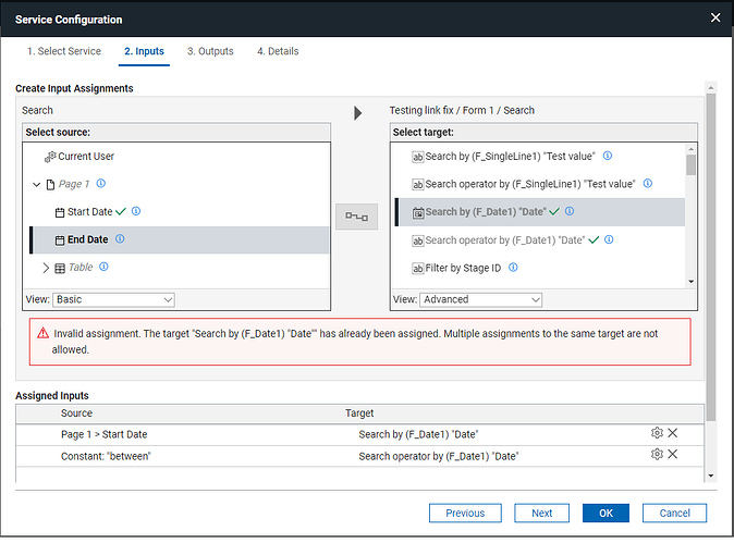

I was so excited to see the new "between" and "not_between" operators in the service configuration editor, but I'm having trouble using it. For example, I want to search for records where Date is between a specified start and end date, but I can't map both the start and end date to the Date field in the service (see attached image). I know I could create a service by URL that does this same thing, but it would be great to use the "out of the box" functionality.
I believe this is a limitation in the UI and we will investigate it.
