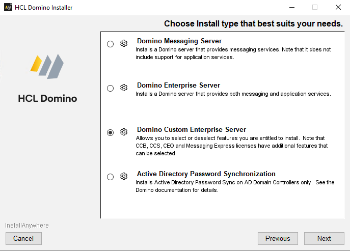

Hello Damien,
Rerun the setup and select the "Domino Custom Enterprise Server" option as per below screen shot.

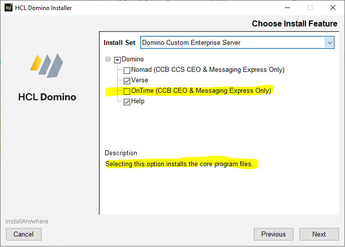

For Ontime installation, enable the check-mark for Ontime, then select Next.
If you want to install the Nomad task on the Domino Server, select that option as well.

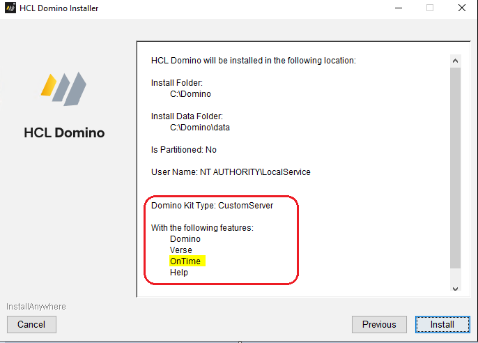

In the next window, we will see the Ontime feature will be installed on the server.

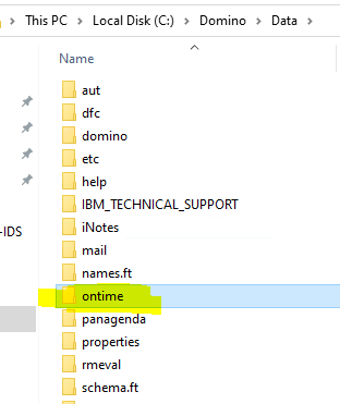

We can see the Ontime folder in the Data directory now.

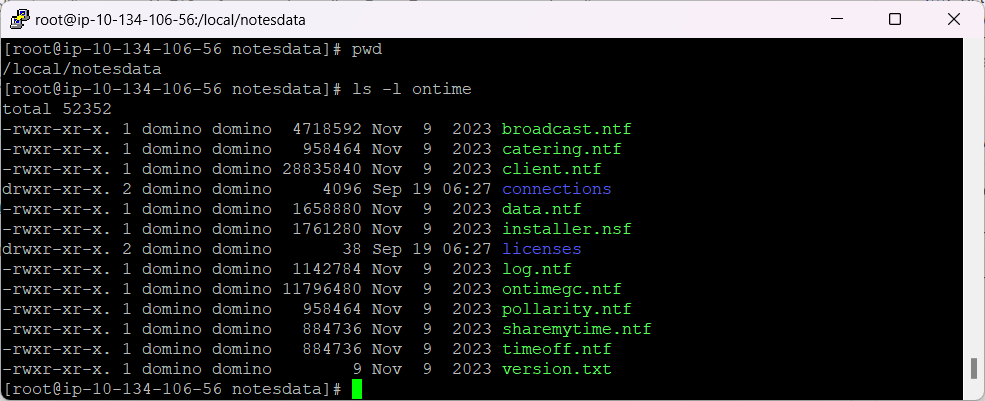

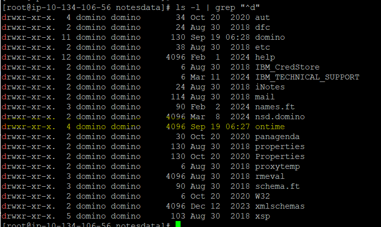

You need to rerun base V 14.0 Domino installer followed by FP2 & IF1 to get the OntimeGC. Please refer the video how you can select the OntimeGC in Linux Domino V14 installer.
After installing with the said option on Linux you can see the ontime folder as below.
