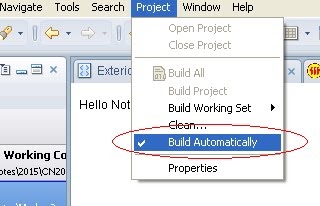

Subject: Issues in opening XPages on NotesClient 8.5.1
Probably the following post may help you,
let me know if its useful…:slight_smile:
Subject: Build and Clean do not work
thank you for the hint, but build automatically is turned on. we also ‘cleaned’ the project multiple times but it does not help as well.btw: in the notes client, everything works fine.
